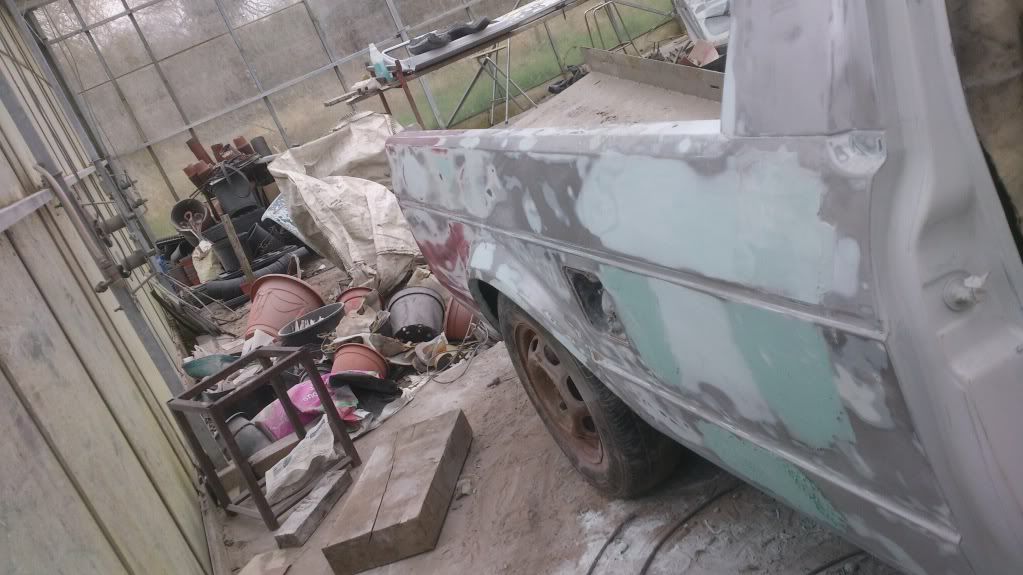

well bit of an update, not had much chance to do anything been absolutly flat out, nurserys busy season that and the weather, working out side in the rain aint fun. well any way a few photos.....

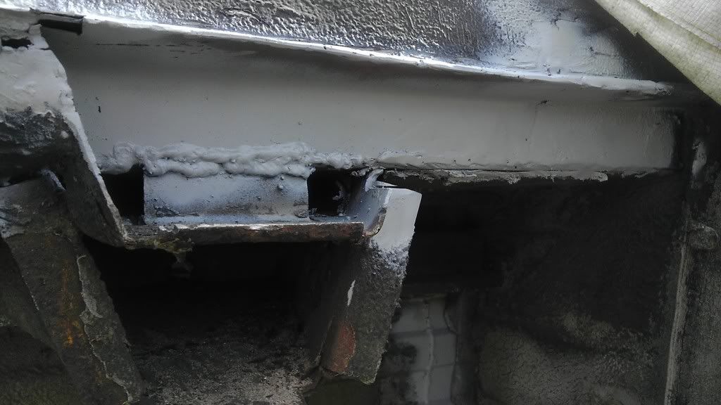

stripped off the repair patches
these were just stuck over the bad bits with filler :/ ...
cut all the bad out
welded the fist peice into the chassis rail treated it with some vatcan and some galvanising spray paint...
got the bed repair in, just got to grind the welds off...
vatcaned the back side, will do the front when I get it tidyed up abit.
I have done the hole below it the same but forgot to take photos
I have also fliped the rear axle using some propper saddles, I did this while the axle was on but again forgot to take photos, but i have now decided to take it off and blast it and paint it, do the job properly.
bought some beetle shocks for the flip the other day but when I got them home
... took them back and they swaped them for me so they will go back on after it has been painted. also bought some more goodies all waiting till the time is right..
I was afer a caddy on ebay, all the bits that I needed to finish my project and even an AAZ engine... look on ebay tonight to check and it has been ended early. so that idea is down the pan any way shall keep looking. hopefully it should progress abit faster now things are slacking off :)

Yeah dude I am painting all the repairs as I go along just forgot to take the photos of that bit .... But yeah getting the welding sorted there are a couple of bits on the load bed to do a small price on the sill and where the bed joins to the arches on both sides need sorting.... Then blasting it and stone chopping / waxoiling the underneath , replacing the brake pipes, painting the axle up, re fitting sorting the tank then back on its feet for prep for the respray :)

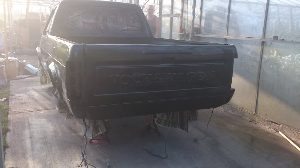

well a bit of an up date been a bit steady latly.
cut out the bit that was rotten in the bed and arch on the drivers side
made up a repair pannel for it
got it tacked in just need to finish it off.
after i had filiped the axle properly with the propper saddles i deacided i might as well take it all to bits so it can be painted properly and look abit better
axle off
then you know how it is one thing leads to another and well......
quite tidy up there..
all the suspension running gear is off and blasted, being painted black today.... shouldnt have blasted it on the barrow though Approve
bought a new few tank the other day, got that blasted which showed up some weeping so that is being sorted out today, got a bloke welding in some patches today, it is a diesel tank but i still think he is a brave guy Confused.
while that was being blasted the guy blasted my bed to see what is lurking.
i hate this load bed Broken Heart oh well lets look for another repair pannel now.....
oh well on a good note got my paint the other day and some wheels for it and my seats!!  ...just need to get this bed done and i can move onto the fun stuff.

chassis bit repaired (covered in sand inthe photo from when we sandblasted another bad bit .. )
poking around abit found this
which turned into this
and then into this
went abit further down found the spring hanger was rotten and the sill either side of it .. no pictures of it bad but got the sill peice in
just need to make up the spring hanger for it .
so decided to see if there was any more and lo and behold
the other arch was the same (hole was plugged up with duct tape and filler, proppa bodge!!! )
spring hanger
and more sill under it
great lets have abit more welding done on it then! ..

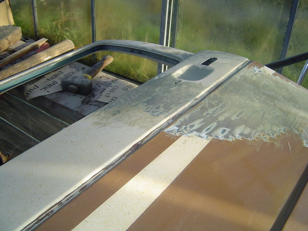

just a little up date, finished all the wealding in the bed, just needs re blasting and a skim of filler but that will come in the body work part ..
fliped the caddy the other way to get at the bits that needed welding that i couldnt get too ( was more careful this time but i will be anxious for dents when rolling it back)

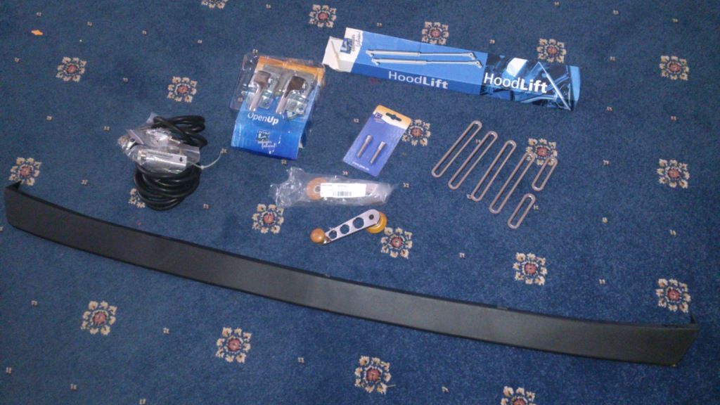

well christmas out the way got a few bits off me parents brother and girlfriend for me caddy
stainless dash vents
door pins
inner door handles
hood lifters
window winders
cl chin spoiler
manual boost controler
and an alarm central locking kit :)

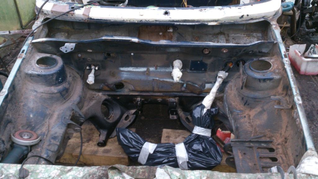

finished striping the engine bay out
got the bed and the bay blasted
few more repairs to do
all primered up in the bed and the bay
pulled a few of the big dents and sanded andfilled where needed
all schutz'd up

arches and cills shultz'd
few engine bits painted up
patch in the front vallence

only a quick up date had a day of preping bits for paint and getting abit of colour on a few bits :)
quick dusting inside the cab
calipers sprayed
few other engine bits, mounts and servo sprayed, thats all the straight black done now need to spray me silver bits :)
got me a tailgate last night so got that preped and the light pods preped too need to work on the doors, bonnet, and wings before the weekend:)

Well not got a massive amount of progress done at all with starting my new job I have not had chance to do alot, but have done abit
Got me gear stick modded just need a thread tapping on top and then iI can start work on the top :)
Been busy flattening back the body still filling and flatting, I hate that job though so I keep avoiding it :/ ....
Also got that rear quater stitched in will get a photo of that soon...

 Right moved the engine over to the Caddy, bloody heavy pig that was!
After about an hour or so and abit of blue air the engine was in and with only one casualty
I have since masked it off rubed it down and blown it in...

Guess there was no more tip toeing round it I had to get on with the body work :(
The corner that was stitched it
Filling and priming and priming and filling and knocking the dents out and filling and rubbing and priming sake! How can anyone enjoy this bit?  Not even half way yet!  :(

well last night at around 20:00 the green house cooled enough for spray although we ran out of light so we didnt get to lacquer .. so today its going to get 2000 grade flatted , another top coat and then lacquered
http://s998.photobucket.com/user/nicko868/media/DSC_0548_zps57a6d385.jpg.html" rel="nofollow">
http://s998.photobucket.com/user/nicko868/media/DSC_0547_zps4a30a76e.jpg.html" rel="nofollow">
http://s998.photobucket.com/user/nicko868/media/DSC_0546_zps24caa032.jpg.html" rel="nofollow">
http://s998.photobucket.com/user/nicko868/media/DSC_0544_zps0e065336.jpg.html" rel="nofollow">
http://s998.photobucket.com/user/nicko868/media/DSC_0543_zps5b4aa020.jpg.html" rel="nofollow">
i think it looks pretty cool matt metalic ;) ..... any way hopefully by the end of the week i can post a lot more progress!

right I know it's been a bit of time since I have updated but I have been busy with it so some photos!
got me interior about sorted, door cards another gggti special! some cheapo window cranks that have been bent to clear the speakers and some golf arm rests... along with me bench seat, sound install and gauges :)
seat base is put because I still need to extend my seat belt retainers
tried to recover my dash, I gave up and drove to your for a new one!!
front indicators in, resistors in and now flashing correctly cheers MLBV!
're stone chipped the bed
exhaust system officially done! 2.5 stainless front to back with a 18 inch silencer half way down
and finally engine all piped and wired. inter cooler in place.... would have had it started but the fuel filter housing was drawing in air so that is the next job :(
brakes have been bled in the tyres are on the wheels.... it has been a big push trying to get it done for RR but I have just fell short :(
