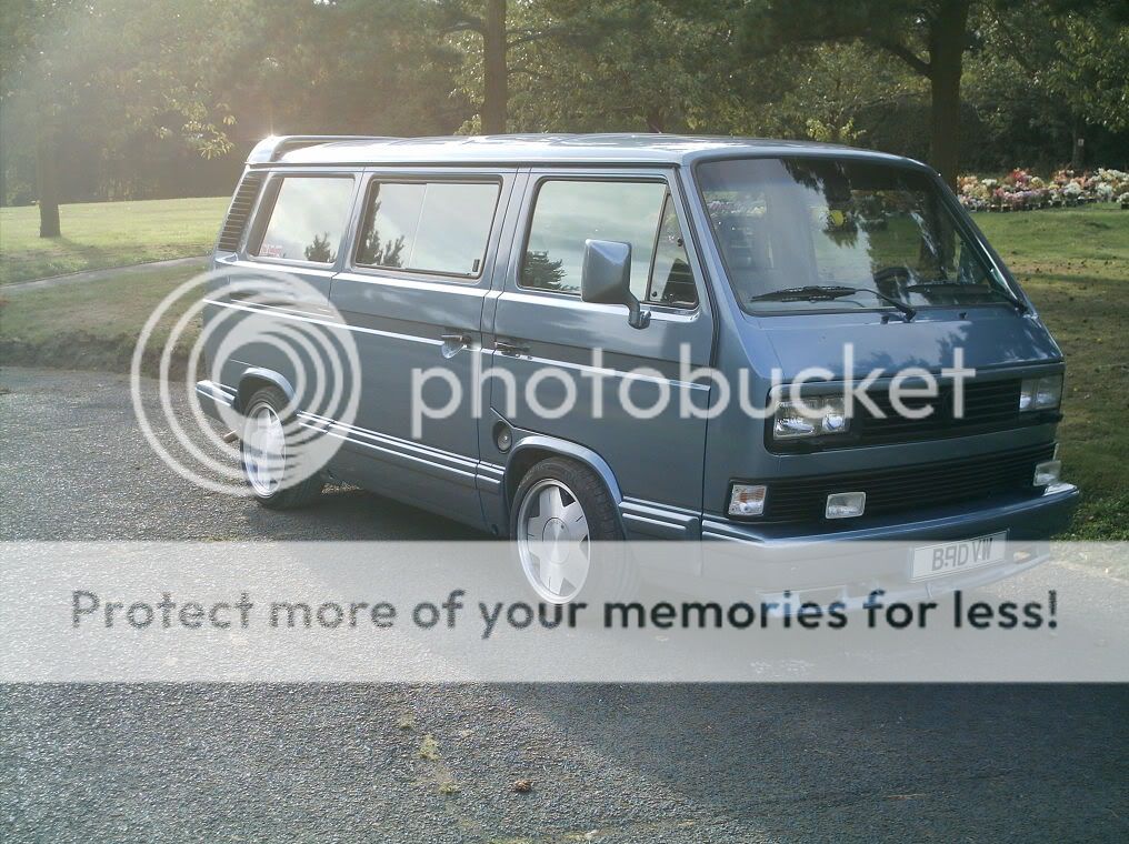

Design 90's come in the following sizes and offsets.
6X16 with 52mm offset
7X16 with 55mm offset
7.5x16 with 65mm offset
8X16 with 52mm offset
9X16 with 52mm offset.
The 6's, 7's and 8's (at the back only) will all fit onto the T3 with adaptors of or near 23mm.
I ran 16X8's with 52mm with 245/45/16's on my panel van and had no probs with the door clearning.
MG

    Posted By: jamiegolf
    Date Posted: 31 May 10 at 17:42
    heres the new wheels fitted to my t3 on saturday
    w202 mercedes C-class
    genuine AMG 17 inch
    7.5 inch width
    not sure on ET
    5mm spacers on front and rear (rears could be 10 or 15mm)
    5-112 pcd
    wheel bolt holes need enlarging from 13mm to 14-15mm to clear wheel studs.
    wheel stud kit required
    http://www.mybannermaker.com" rel="nofollow - [img width=640 height=79 - http://i.imgur.com/Ysu01.jpg[/img -

    Now i`m pretty happy with my wheels that i`ve got fitted, thought i`d stick up a pic -
    Porsche Cup Repros in 5 x 112 fitment
    5 x 112
    7J
    ET 35
    5mm spacers on the front (you could get away with none, but clearance is about 2mm!)
    245 40 17 Tyres front and back
    Longer Rear Studs
    1989 T3 Bluestar AFN TDi Flipped Gearbox
